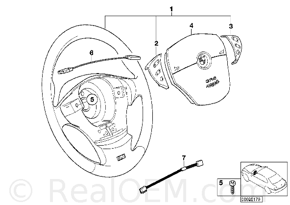

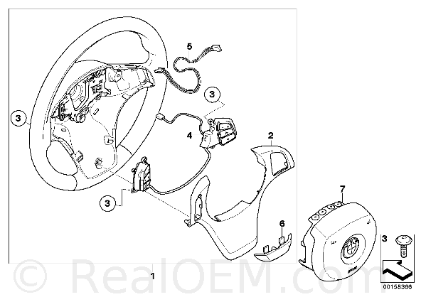

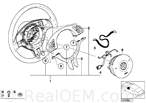

ST5618 2012-11-12 04:27 PM
看國外網站的車主改過這幾款方向盤,真的不難。可以參考這一篇 www.bimmerboard.com/forums/posts/610491
看過這幾款方向盤有人改成功:
http://www.realoem.com/bmw/diagrams/z/b/85.png
http://www.realoem.com/bmw/diagrams/h/s/241.png
http://www.realoem.com/bmw/diagrams/k/b/33.png
